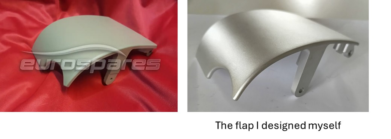

So here is the way to save over 80% over what Ferrari charges or what Ricambi charges for the Lateral Capote Flap (66462000 and 66462100), and you will get a CNC machined aluminium part rather than the OEM fiber glass part.
Basically I damaged one of my OEM flaps on my 360 Spider and decided to make it myself, so went to rent a 3D scanner, scanned the non-broken flap, retro-engineered it, sent the file to a Chinese CNC manufacturer and got 2 brand new flaps, made of aluminium.
Result: 2 flaps CNC machined in Aluminium 6061 for USD 271 (ex shipping, ex VAT)
This is a 76-86% discount vs the Eurospare aluminium manufactured flaps and the OEM flaps respectively (shipping excluded) available at Ricambi and Eurospares,.
 - Ferrari 360/430 Spider Lateral Deflector (66462000  and 66462100) now cost GBP 528 + VAT each, and then need top be painted.
 - Eurospares also has “Eurospares Approved part” (which I understand are made out of aluminium) and cost GBP 425 + VAT, and then need top be painted. (Based on an FerrariChat discussions, these Eurospares flaps were c. GBP 309.75 in January 2024.)

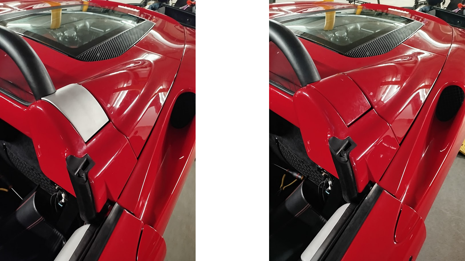

Beyond the unregular accidental breaking, these OEM flaps, made out of fiber glass I believe, age badly and start cracking, in particular at the attach points.
My result:
 - Left: my DIY aluminium CNC machined flap for USD 135 (ex VAT and ex-shipping)
 - Right: The OEM flap that was used for the 3D scanning

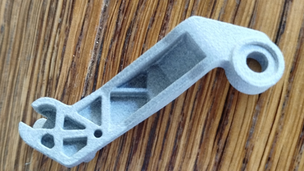

I also decided, just for fun, to get the support lever (Parts 66458700 and 66458800) professionally 3D printed (using the MJF technology) out of heat-resistant nylon for USD 1.64 per item, i.e. 98-99% cheaper than OEM parts (GBP 64 + VAT for c. 5g of plastic… real joke), and I provide the files below to allow anyone to get the same supports for cheap since these retro-engineered parts are not commercially available as far as I know.

Just to give you a feel of what I received today below and compare it to the great work of Eurospares (I admit theirs seems 99.9% identical to the OEM one – for mine, I simplified on the non-visible part to make CNC machining a tiny bit easier - link to the Eurospares approved aluminium part for your reference: https://www.eurospares.co.uk/Parts/66462000/Eurospares?pi=68203):
I also got 3D printed in heat resistant Nylon using the MJF technology the flap holder (Ferrari part number 66458700) and was blown away by what I received (except the hole was too small, but my fault, so drilled it with 6mm drill bit and was fixed (and I corrected the file in this chat).

 - Left Flap Holder (retro-engineering of part 66458700)  - Retro-engineered by me, no guarantee it will last long
https://drive.google.com/file/d/1rTG8yfV8cTm2pwnj23I0eV3qeyaWK3p0/view?usp=drive_link
If you send this STEP file to a 3D printer, you should get the same flap holder that I ordered for less than USD 2
 - Right Flap Holder (retro-engineering of part 66458800) - Retro-engineered by me, no guarantee it will work fine  or last long
This is a pure symmetrical exact copy of the link above – USD 2 to get it 3D printed in heat resistant nylon
https://drive.google.com/file/d/1SO_Npo3L4pUUwS6Gsjcp1ZULR-0sQzGk/view?usp=drive_link

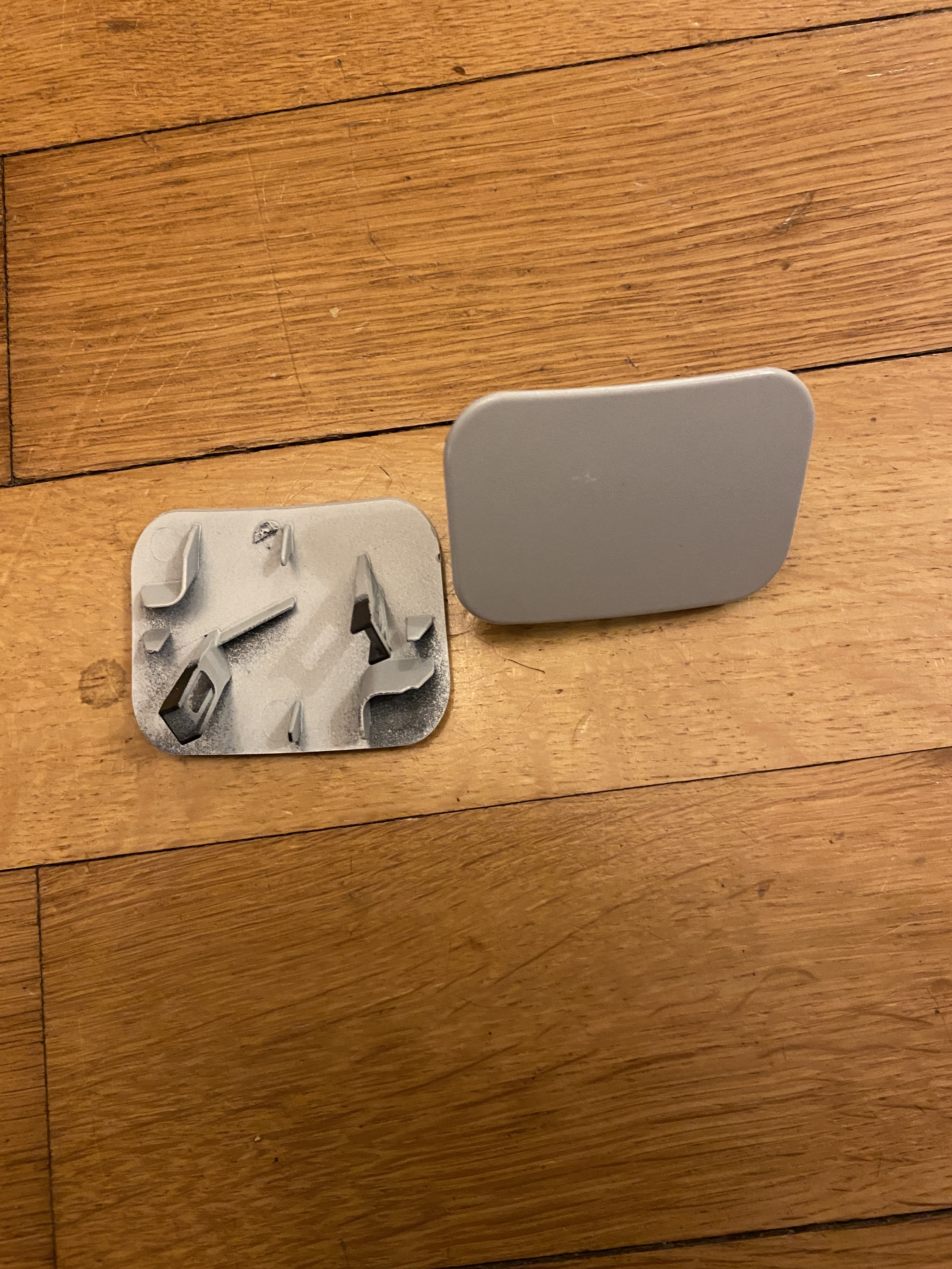

j avais une fois envisagé la même chose pour les caches de lave phare. Sans aucune compétence en la matière ça s était arrêté là. cette pièce pourrait elle être un candidat à l exercise ? Dernier prix en date 65€ HT l unité (OEM)

Hmmm, cette piece m'a l'air d'etre une bonne daube a retro-engineerer... en plus, j'ai aussi ces laves phares sur la mienne, mais ne les ai jamais active ;o)
Perso je vois ces parts (65896500 et 65896400) en OEM chez Eurospare a GBP 35.13 + VAT, donc pas certain que cela fasse enormement de sens de les retroengineer, mais le jour ou Ferrari arretera de produire ces parts, on sera pret ;o)
Si tu veux, je peux essayer de la scanner avec le scanner que j'ai utilise (on a un youth centre qui le loue pour CHF 10 de l'heure et 1h est totalement suffisant pour le scanner) et essayer de le reproduire en CAD.
Il faudrait juste que tu m'en envoie un (le plus clean / sans partie abimee) par la poste en Suisse car pour etre honnete j'ai aucune envie de m'embeter a demonter un des miens / risquer de le casser LOL. Dis moi si c'est une option pour toi.
Sinon pour le mode de production:
 - CNC machined en alu: perso j'oublierait cette methode car (1) tu as besoin d'un peu de flex pour les attaches, et (2) tu es oblige d'utiliser un CNC avec 5 axes qui augmente considerablement les cout, donc ta cover reviendrait probablement a EUR 30-40.
 -  3D printing en methode MJF: j'ai franchement hallucine par la qualite que j'ai recu pour mon flap holder, je ne m'attendais pas a ca. Vu les USD 1.64 que m'a coute le holder a produire, je dirais que la couverture reviendrait a probablement US$ 5. Le soucis principal que je vois au MJF Nylon est que la surface est un peu "grainy", mais vu que la surface est assez flat, avec un bon papier de verre a 300 grit, je pense que tu peux le rendre paintable en peu de temps
