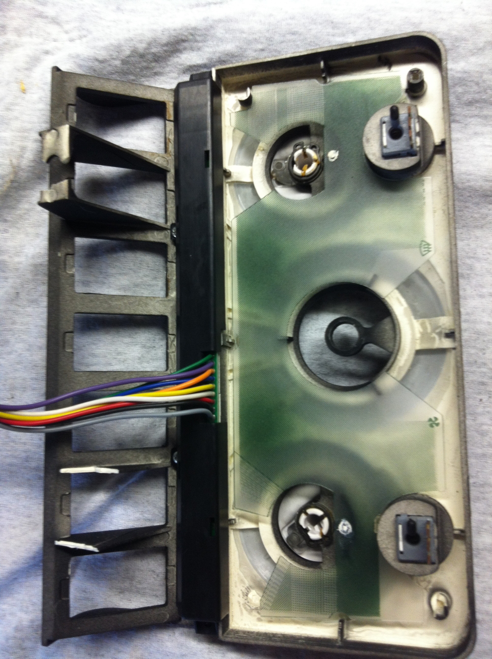

stevepaa
I cleaned the row of switches with denatured alcohol and they look great.  Only one of the knobs on the climate panel is sticky.  My real problem is the tabs holding the climate panel in place are broken.  I need to repair.  I have some plastic pieces on order to replace the  posts which sheared off and I will make new tab supports from aluminum sheeting.
