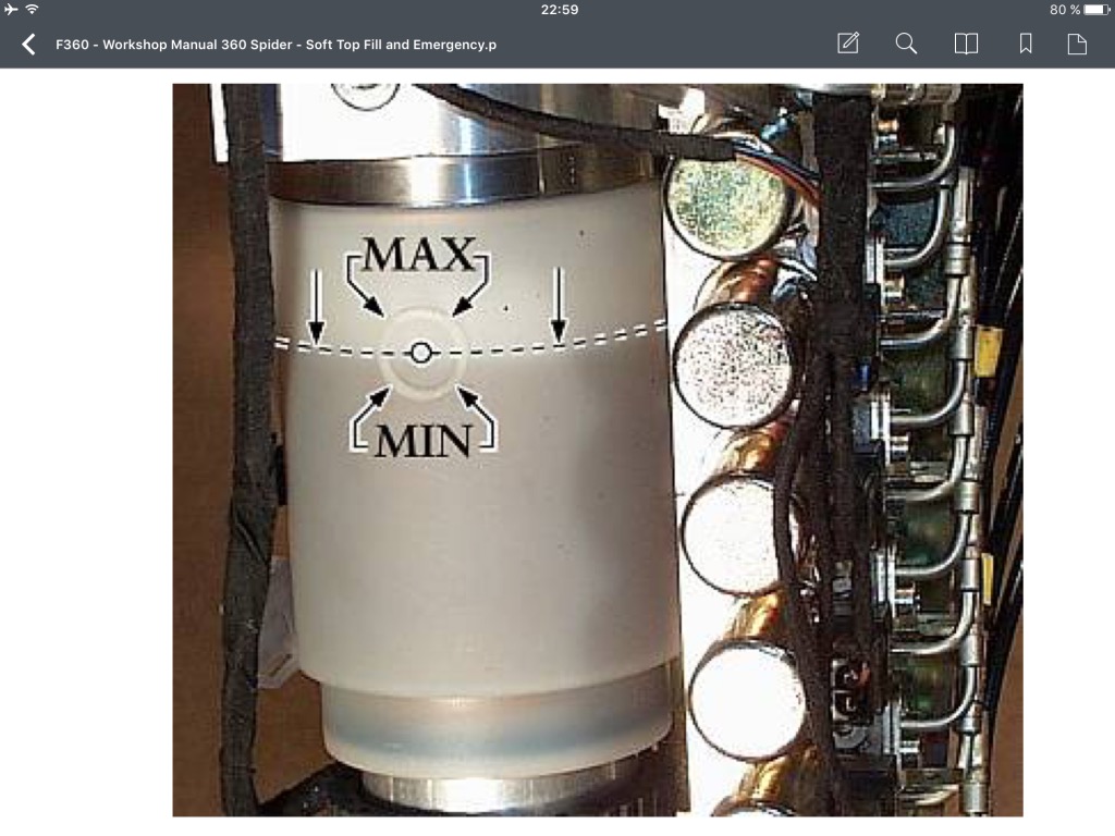

Après vérification, j'avais donc utilisé un extrait du workshop Manual pour vérifier le niveau.
Ci-dessous un extrait de l'extrait !
"Topping up the oil :
The system is self-draining. After replacing a piston or after topping up, it is always best to perform
several complete soft top opening/closing stages to allow the system to expel any air that may have
entered the circuit.
Then check the oil level in the hydraulic unit tank, as follows.
•    Remove the RH lining on the door’s rear pillar ( M 3.04).
•    With the soft top gathered in its housing bay, the level should be at the mid-point on the indicator
found on the tank. The arrows appearing along the perimeter of the circular indicator represent the
“MIN” and “MAX” levels of the oil in the tank.
