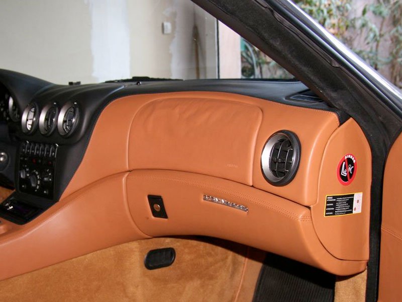

	Over the years, it is recurring on Ferrari that the leather in the cabin relaxes in places, especially at the passenger airbag. The first solution is to take the time to find the right specialist to make an appointment, to deposit your Ferrari then pick her up. And good work is not cheap. Can't you do it yourself, quicker and cheaper? PhilM offers, through its tutorial to tighten the leather airbag his Ferrari 575M, to discover the steps to have the pleasure to do it by yourself on your Ferrari.
</p>
<p>
</p>
<p>
	Your Ferrari leather will tend to relax especially if you leave it in the sun or if you live in the south of France. This is indeed the heat which causes the leather to shrink and the glue is no longer working. You can regularly observe this phenomenon in the interiors of Ferrari F355, Ferrari 456 or Ferrari 550 Maranello, for example. To prevent this problem at most, you have to regularly maintain your leather by cleaning and nourishing it. When the damage is done, this is what it may look like before action:
