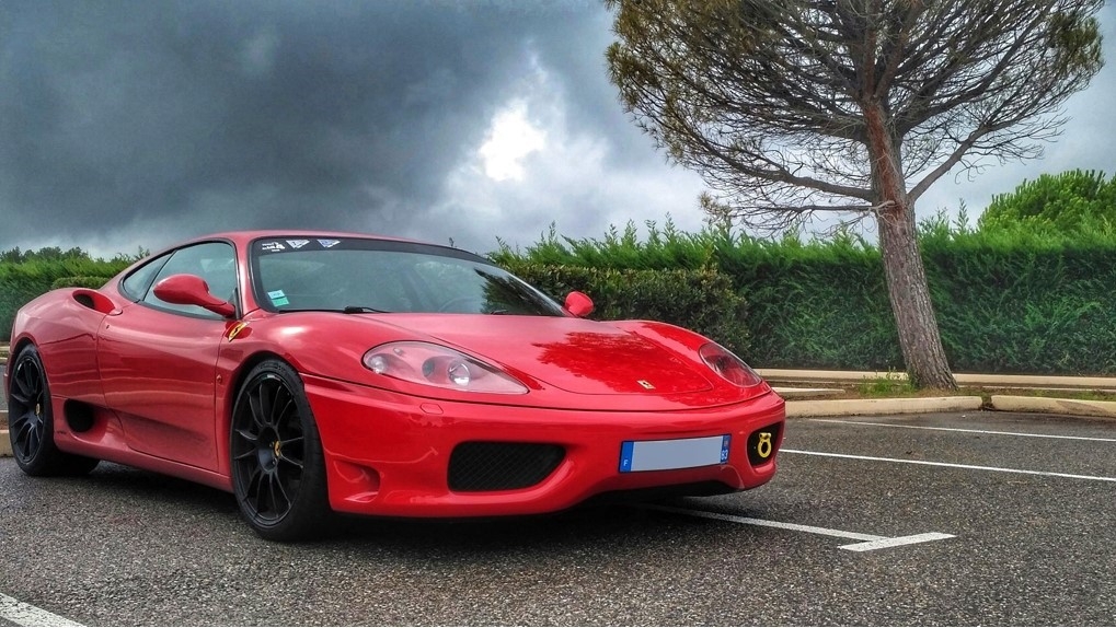

My January 2000 Ferrari 360 Modena, acquired in 2012 with 56,000 km, now totals around 75,000 km. It sleeps in a closed garage (therefore in the shade) and temperate and at each stop in the sun I install the sun visor for the leathers and it hibernates in July-August to protect it from the heat of the South (the engine compartment says thank you!).
For the inconveniences I have experienced on the interior side, I would cite the classic sticky plastics, which can be treated very well with isopropyl alcohol, elbow grease and patience. The exterior door opening control cables (ref. 68602600) which get stuck in their sheath. The headliner peeling off. The air conditioning button that no longer held in the OFF position (repaired for zero euros). The gear lever foot ring (ref.174967) which becomes oval over time and affects the gear change manoeuvre. The plastic of the ashtray is of poor quality and becomes brittle over time. The door seals settle over time, creating a leak in the upper part of the window and air noise in the rear view mirror. The most annoying was the potentiometer of the accelerator pedal (ref. 170038), which makes the engine amorphous when the feedback of the depression of the pedal is no longer operational (unlike the F355, there is no no more connecting cable between the accelerator pedal and the throttle valves on the engine side, everything is electric like a Playstation pedalboard!), a classic fault on the 360, which is very easily repaired.
On the engine compartment side, my only real failure was the left exhaust manifold which cracked. I had it initially re-welded by a pro but I have since switched to aftermarket collectors from the Italian specialist Supersprint, designed to last. I also experienced the classic cracking of the support brackets of the Tubistyle pot and the connecting bracket of the dual exhaust outlets. The two large water hoses (ref.181742), which carry the coolant to and from the radiators located in the front bumper, have cracked over time. I found after opening the air intake plenum for a completely different reason, the air compensation butterfly (ref. 182092) which had disappeared and fortunately the two small screws, which fix it on its axis, have not been sucked in by the cylinders! Finally, seeing frequent "slow down" alerts while it was inconsistent with the conditions of their appearance ("cold" engine for example), I replaced the two centraline (catalytic temperature control station) by the signal decoys of the catalyst thermocouples from Technistrada.
The air conditioning compressor has died, most certainly a victim of the heat radiating from the engine, but its replacement is a formality starting from an Opel Vectra B air conditioning compressor base (ex ref. 8FK351102-001).
On the running gear side, I experienced the suspension fault reported on the dashboard. It was the vertical acceleration sensor (ref. 232690) located in the engine compartment (also a victim of the surrounding heat).
When I took my engine out at 67,000 km and 16 years old to give it a nice overhaul with a lot of preventive, I could see that the two engine silent blocks (ref. 182142) were in fact out of service but their configuration makes it hard to see and they know how to hide it! While the silent block of the gearbox (ref. 186698) is easily noticed when it is out of order. When the latter is replaced, I advise to insulate it thermally by offering it the dedicated heat shield (ref. 67912300). I took the opportunity to replace the clutch (which was not HS) and in fact I mounted a Hill Engineering thrust bearing. I replaced all the oil, DA, water and fuel hoses that I had the chance to do. At the same time, I took advantage of the easier access by removing the engine to thoroughly clean the engine and the engine compartment, redo the thermal insulation and add some where I thought it would be useful (DEI plates ref. 634162) and finally redo the paint (expansion tank, oil deaerator, cylinder head covers, intake plenum, etc.). The list of parts replaced during this operation was quite substantial (for around 6000 euros of parts) and justified by the combination of their age/dilapidation and their easy accessibility: universal joint boots, complete distribution, water pump, chain tensioner oil pump with its shaft (tensioner in poor condition...a recurring topic on the forum), numerous engine ball bearings, engine thrust bearing silent blocks, engine gasket kit, gearbox oil cooler (another topic recurrent on the forum), revision of the starter and the alternator by the specialist Var Electric Auto, etc. Beforehand, I had checked the compressions of the engine because if a cylinder was sick it would have been a good opportunity to take care of it!
Before or after this major overhaul, I did preventive replacement of the thermostat style (ref. 183758), expansion tank cap (145030), richness regulation lambda probes (before catalysts) (Bosch 0 258 007 001) , catalyst efficiency diagnostic lambda probes (post catalysts) (Bosch 0 258 006 196), flow meters (Bosch 0 280 218 012), ignition coils (Bosch 0 221 504 015), spark plugs (PMR8B), battery ( Varta E44), etc.
Finally, my last technical fact dates back to the beginning of this year when I noticed that the front right water radiator fan was out of order. I wrote a topic on the forum entitled "Fan out of order on 360 Modena" and the important thing is to remember that a small pebble can get lodged between the blades and the strapping around them and thus block the propeller and burn out the electric motor.
