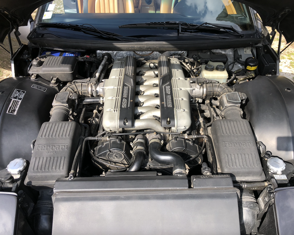

The V12 of the Ferrari 456 has a displacement of 5.5L (and yes 12 times 456!) and only 442HP, which makes it a not too powerful engine with only 80 HP/L. For example, the engine of a Ferrari F355, sold in the catalog at the same time, produces almost 110 HP/L.
Even if it is not the only recipe for reliability, it is a robust engine that does not suffer much if regularly maintained.
I have heard of the valve problem, but not all vehicles are affected. The valve clearance adjustment had been done on mine by the previous owner and I never had any problems in that regard.
